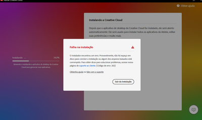

Estou com o mesmo problema e não consigo instalar o CC, aparece o seguinte erro

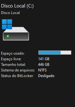

E tenho espaço no disco
Mar 24, 2023 Mar 24, 2023

Fiz o procedimentos mas n funcionou, nao consigo instalar o CC

New Here ,
I had a problem updating, so I uninstalled to install again, but I can't keep getting this error but I have disk space.
again, contact adobe support, and please don't post duplicate messages.
