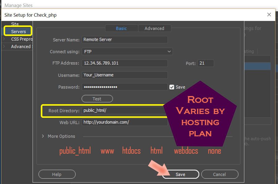

If unable to connect to remote with a dedicated SFTP client, you have other problems. Check that your connection settings are correctly entered and the server's Root Directory is defined properly.  Hosting plans vary.  Some use public_html/ or www/,  htdocs/,  html/ or no root directory.
Alt-Web Design & Publishing ~ Web : Print : Graphics : Media
