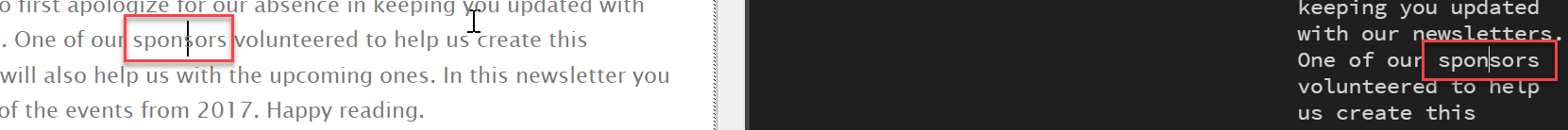

Now switch to Split View.  See my screenshot below.  I clicked in the middle of a word in my Design panel.  My cursor is located between the S & E in both Code and Design view exactly as expected.
What are your results?

I have exactly the same problem, which has lasted for maybe few months. The issue started after one of the latest updates of Dreamweaver. It is a hassle to edit text in the design view, since you never can place the cursor correctly. It looks correctly, but when you start typing, you most likely will type letters at the wrong place. It works fine if I go to code view, but if you have other letters than the English alphabet, you are in trouble again, since they are not translated automatically as if you type them in design view. It regards all web projects I have. I thought maybe it had something to do with Bootstrap, but I just edited a plain newsletter page with only few css styles and no link to any Bootstrap and the issue is still there. Many times the cursor is also just blinking in the middle of a letter and I need to guess if it will type to the left or to the right.

It happens on all files, except for old ones created for 5 years ago. There is no code errors. Have a nice green check mark symbol. You may copy the codes from a newsletter that is to be released and see by yourself how the cursor is not displayed correctly. I use a split window with Design view on the left and code view on the right. If I edit in the Design view, the cursor is in the middle of a letter, while it looks correctly in code view. The link is: Newsletter E-Mail :: Child Africa

Below you can see how the cursor is in the middle of the letter "S" in the Design view and correctly displayed in the Code view. I had no cursor issues with this few months ago, but have issues now if I open those files.

I am using two screens, one DELL 32" 4k screen and the other one is a DELL 24" HD screen. When you asked me to try another computer, it hit me that maybe it has something to do with the screen, so I moved my DW window from my 4k screen over to my HD screen, and suddenly the cursor was placed correctly. Really strange. Looks like there may be some trouble between DW and the driver for the screen. It works fine in other programs like Photoshop, InDesign etc. Only DM that has these cursor issues.
