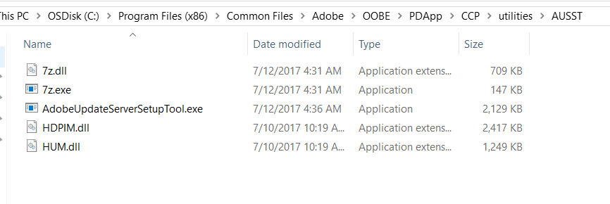

Can you please make sure of two things.
1. In your AUSST server , you have correctly set up Handler mappings.
2. The AUSST folder contains all the files mentioned below.
~Rohit
Explorer ,
Jan 11, 2018 Jan 11, 2018
We are using Apache for our web server, as far as I am aware the Handler settings are only needed if we are using IIS? Plus the stage we are at is before any Adobe app is downloading updates from our server, we are still trying to set up the server but encountering errors when using AUSST.
Regarding the AUSST folder, yes all those files are present and have the correct file sizes shown in your image above.
