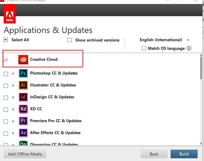

Thanks, our engineers have looked at the logs and reviewed this thread. The issue is caused by outdated 'core components'. When you build a package you will see 'Creative Cloud' as a mandatory item in the list. This is not the desktop app but rather the 'core components'.
The fix is to build and deploy a fresh package with the latest core components. The desktop app is not required, you don't necessarily need to include any other applications either.
Let us know how that goes.

Explorer ,
Apr 30, 2018 Apr 30, 2018
@alisterblack
Does it matter if I used the CCP or build the package within the Admin Console?
Thanks
Adobe Employee ,
Either CCP or an admin console package will contain the updated core components. Be careful not to include the Desktop App if that is not desired.
