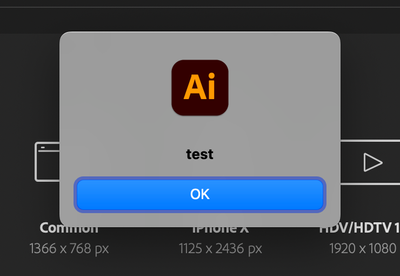

Hmmm... The mostly grayed out debug controls you showed in the screenshot indicates that the script is running but not stopped at a breakpoint. I just tested in Illustrator 2022 using the very same configuration you just posted and got this:
To confirm, you are at least seeing the alert appear, yes?

Yes the alert works. I can run a script. The debugger just doesn't engage. I also see this error message after running a script in the new configuration:
UPDATE:
I restarted Illustrator and the debugger started working! Thanks for your help,  @sberic .
