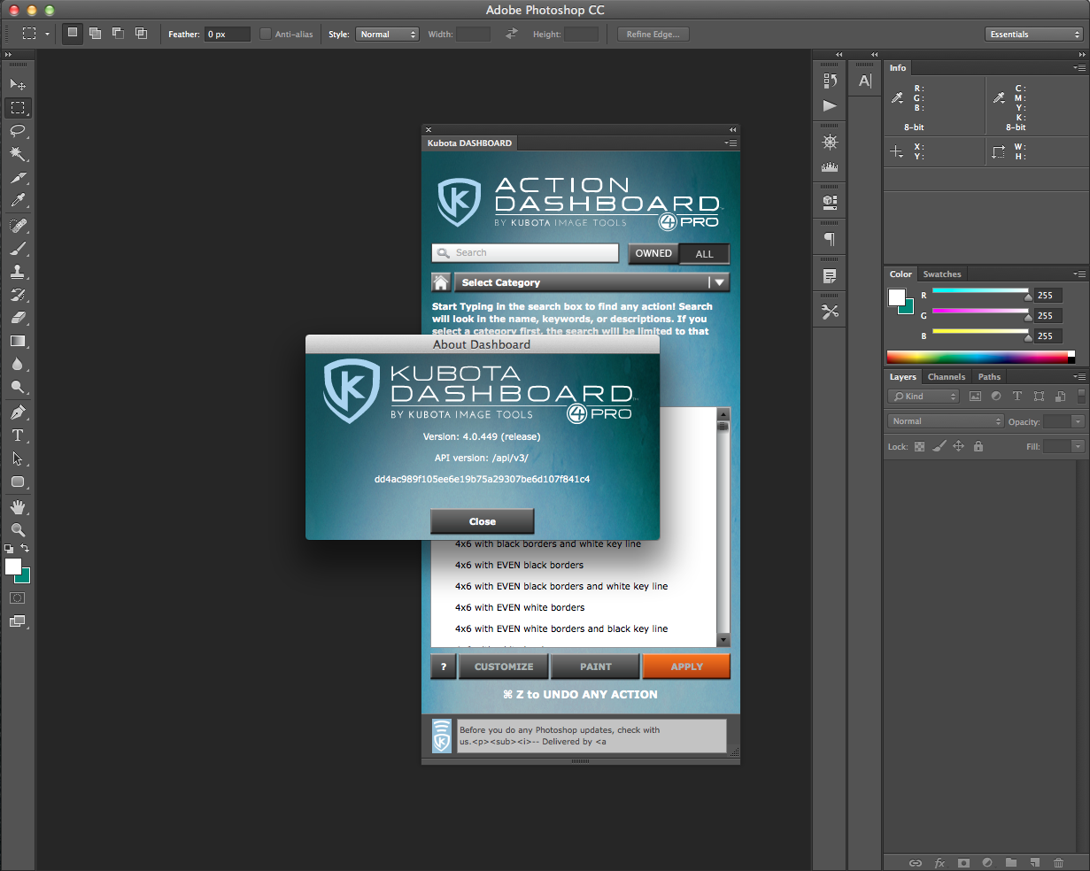

Explorer ,
Apr 21, 2014 Apr 21, 2014
Thanks for responding Davide.  I really appreciate the tips you've done on cs-extensions.com, and your willingness to help on the forums!
I'm not talking about a modal window within the Panel.  I'm specifically talking about the CSXSWindowType.Modal.  Which is a separate Window from the extension.  See this image.
I had thought of the adding another extension of type Modal, but hadn't quite figured out how the two extensions would communicate information, etc.  And as you mentioned, it just seems like a big hack to do it that way.
The ability to open windows from an Extension has been in there since the C++ SDK, and was present in Flash Panels.  I'm hoping that we'd have simliar functionality in the HTML5 panels.
Hopefully someone has some information on this.
