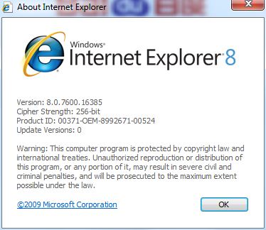

Guest
Jun 23, 2017 Jun 23, 2017
1)Windows 7 Professional
2)see below picture
3)32-bit operating system
4)see below picture
Adobe Employee ,
Jun 26, 2017 Jun 26, 2017
Unfortunately, I'm not able to reproduce using Windows 7 Professional 32-bit and IE 8.0.7600.16385.  The Publisher displays as Adobe Systems, Incorporated:
Have you modified the Tools > Internet Options > Security settings in any way?
Can you try downloading the offline installer posted at the bottom of the Installation problems | Flash Player | Windows 7 and earlier page, in the 'Still having problems' section?

Adobe Employee ,
Jun 27, 2017 Jun 27, 2017
The digital certificate was updated in FP 26 to be more secure.  It was not updated in FP 25.  You have Windows 7 which should support it, however, you do not have Service Pack 1 installed, so you're system may be missing something required to validate the new, more secure digital certificates.  IE8 most likely doesn't support the new digital certificate either.  Essentially, you're running old unsupported OS and browser.  Updating to the latest versions of the OS (installing Service Pack 1) and updating IE to IE11 may resolve the issue.
