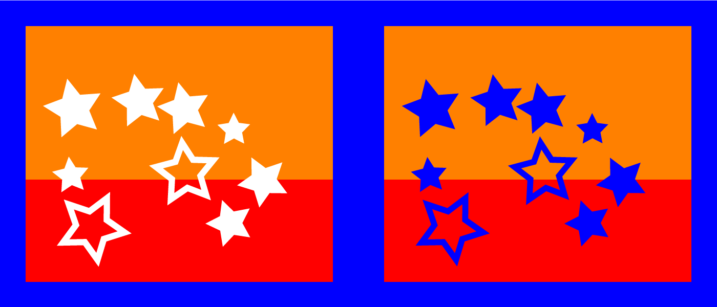

jozsef,
After another look, I believe you can do it in this simple way, see the crude sample below with white punch out parts, two yelllowish/reddish background parts, and a blue background, given that all the parts to punch out are the same colour:
1) Lock the blue background, then select everything (else) and apply the Pathfinder Divide; this makes the artwork form a Group that still looks like the original artwork to the left;
2) Deselect (you can click an empty spot on the Artboard/workspace), then with the Direct Selection Tool click one of the white parts to punch out, then in the dropdown Select>Same>Fill Color, then press Delete; this changes the artwork to be the yelllowish/reddish Group in front of the blue background to the right as desired.
Click to get closer

Thanks so much, this method worked perfectly. Really appreciate it!
