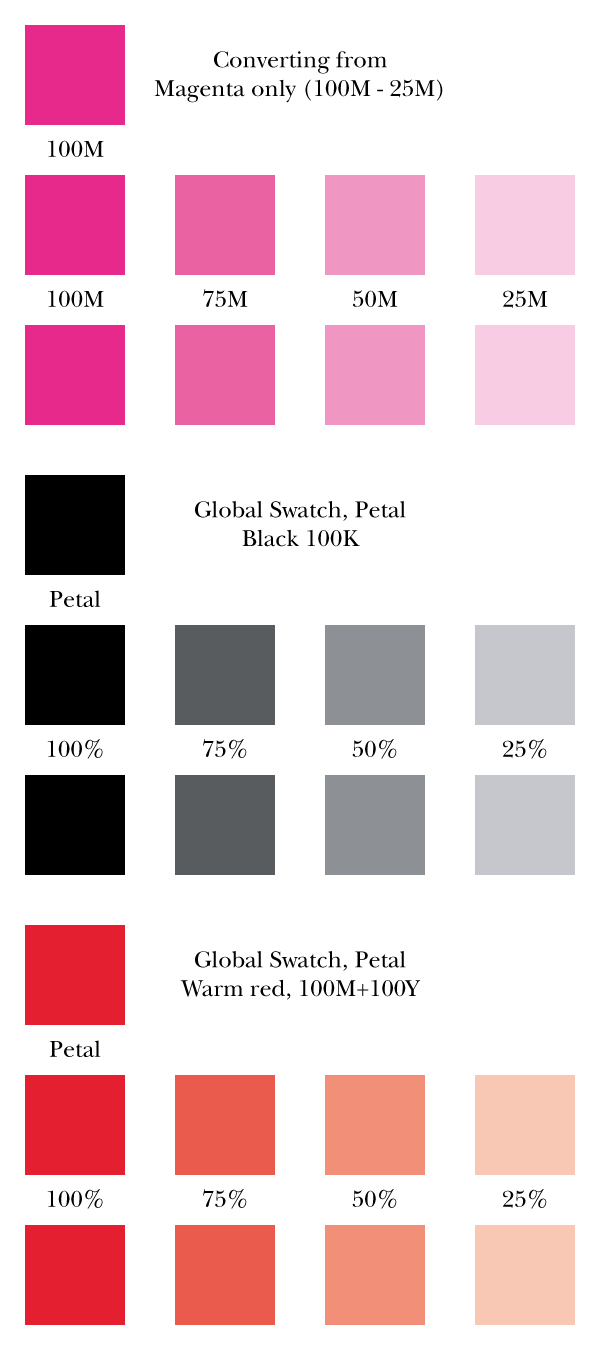

jefwgraphics,
I am certain that it can be done with a script, whether existing or one yet to be created.
The script that could cover any further change, would find and select all instances of a single ink colour of your choice, Magenta only in this case, define a Global swatch as 100M or similar with your choice of name, and then apply that Global colour to each with a tint that is the same in % as the original value in M (25M > 25%). Then you could just change the Global swatch to get the new set.
The following is the way I should use based on % of M, also to cover any further change, as long as no script is available:
1) Create a 100K square and turn it into a Global swatch called Petal;
2A) Select one of the petal colours (you can start in the dark end), then (create and) run an Action that finds the other identical ones, (Select>Same>Fill Color), and remember the M value;
2B) With the Eyedropper Tool, Click the Petal swatch rectangle and insert the M value as % tint;
3) Repeat 2A)-2B) for all the other petal colours until they are all greyish, no more Magenta;
4) DoubleClick the Petal swatch and give it the desired new colour;
5) For any new colour range required, just apply 4).
I believe you know roughly how many values/tints you have and thereby how (un)manageable the task would be.
Here is a screenshot showing the way, Magenta to Red+Yellow, the greyish part of the way preserved by rasterizing:
Click/RightClick to see in full, Click again to get closer
Votes
