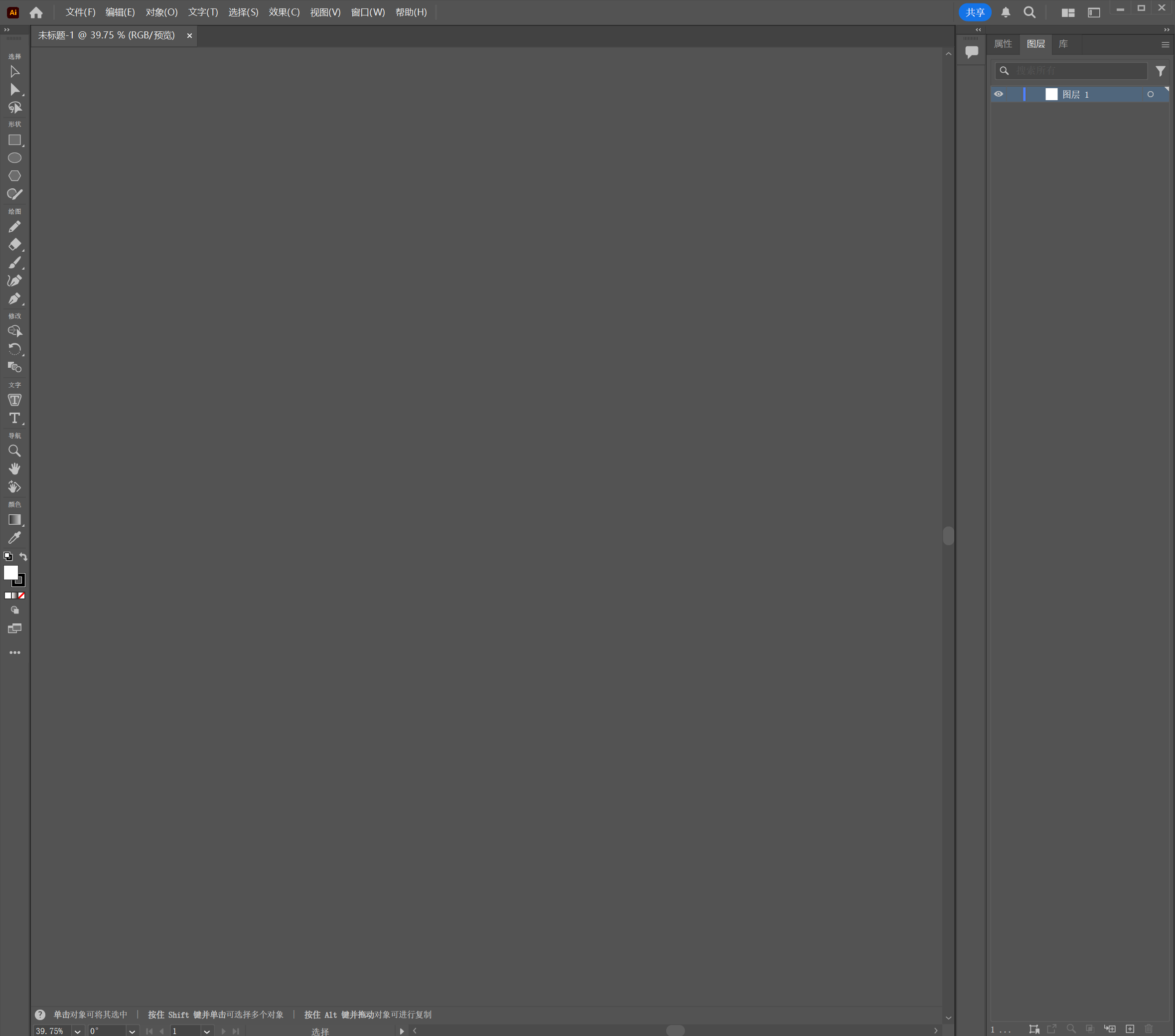

Illustrator has become unusable on my system — the issue affects both new and existing documents.
Problem Summary
  • When I open Illustrator, the New Document dialog’s dropdown menus (Color Mode, Preset, etc.) often won’t open.
  • If I manage to create a file (e.g., A4 CMYK), the artboard flashes briefly (≈1s) and then disappears.
  • Opening existing .ai files shows the same behavior — Illustrator loads the workspace, but no artboard is visible and the UI dropdowns stop responding.
  • GPU Performance is detected and enabled, but the canvas is blank or missing.
  • The issue sometimes vanishes after rebooting, but always returns.

Expected
Artboard should display normally and dropdown menus should work in both new and existing files.
Actual
  • Artboard flashes then disappears.
  • UI dropdowns in the New Document window and toolbar menus stop responding.
  • No crash dialog, only a blank workspace.
