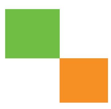

Can somebody help me with the following issue. I'm trying to draw different shapes with coinciding corners. I want to be able to draw a new shape with same corner(s) as another already existing shape. See the examples underneath to get a clearer understanding.
What I'm looking is not a solution that involves drawing both shapes and then using the alignment tools, the x and y coordinates settings or the smart guides.
Any help is much appreciated.
Thanks in advance!

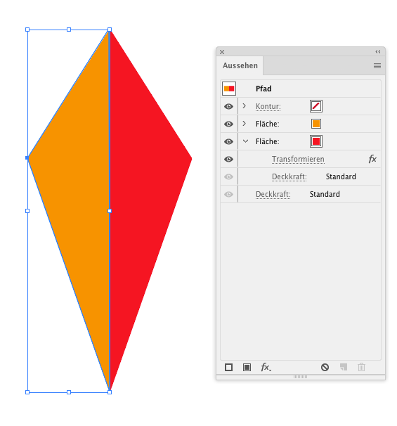

Transform each is not the transform effect.
Basically you create an new fill in the appearance panel. Then apply Effect > Distort & Transform to the fill and you get this:
effect looks like this:
Community Beginner ,
Oct 27, 2019 Oct 27, 2019
Thanks! Even better
