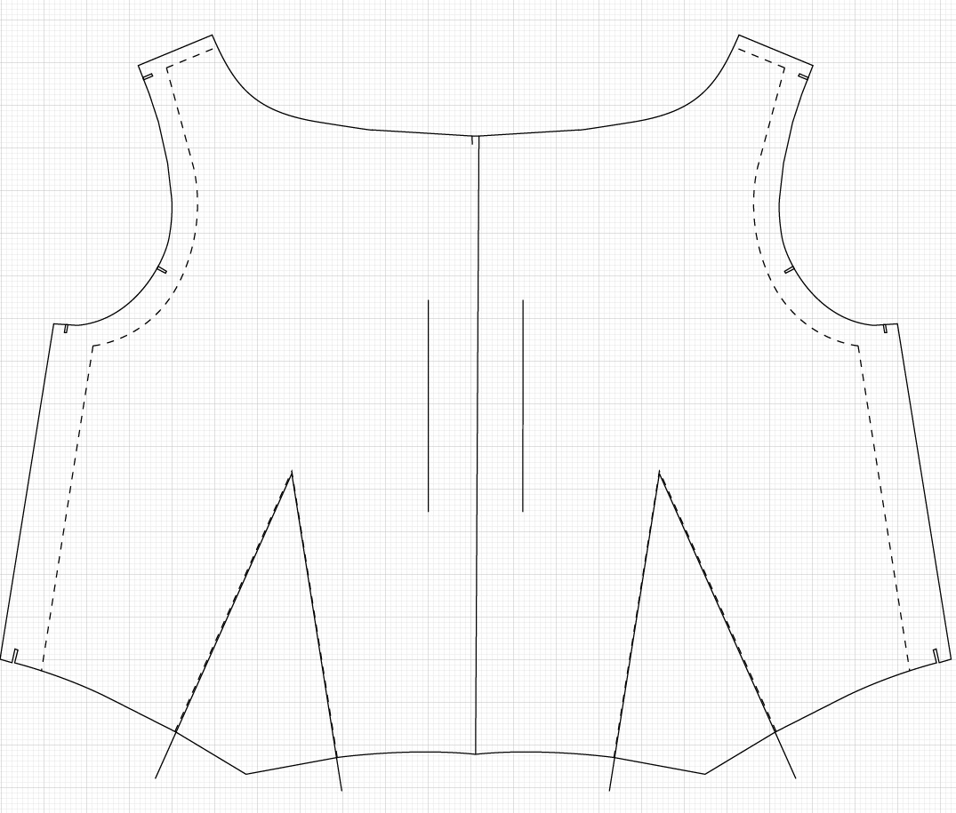

Here is the image, right now the line down the middle represents a seam, but I do not want a seam down the middle of the garment, which is why it must be deleted. There was 2 lines down the middle, but I was able to delete most of one no problem using the pen tool and retracing the line then deleting it. Now I can't delete the other! Each half of the shape is one whole path, so I think that is the problem?
Any help is much appreciated! I'm very frustrated with it, because now I am late on getting it sent out to my manufacturer.

It looks like it was two separate objects against each other. If that is the case, you will need to use the direct selection tool (lower case - a) Select the top point then split the point. Repeat for the bottom point. At this point you will have a line that is a separate object from the other two. Use the move (lower case v) to select the line then hit the delete key.
Next you need to select the top two points and merge then together. If they are far apart, you will see a new line, which is why it would be best to keep the two points as close together as possible. (They can be on top of the other) Then  repeat for the bottom.
This will merge the two objects into one.
