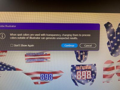

whenever I either create a design or import a template for graphics, when I go to save as an (EPS) for cutting for versaworks I get a warning
 how can I fix this issue?
I've tried putting images or colors behind the image I'm creating, this warning gives me multiple cut lines ? And it sucks, thanks for any advice
4.6K
Adobe
Jul 17, 2022 Jul 17, 2022
The spot colors are in the cut lines?
That is just a warning that you shouldn't change the spot color to process outside of Illustrator. Do you plan to do that? If not, just go ahead.
What happens when you print it?

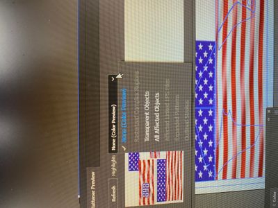

You can check if there is some transparency used with Window > Flattener Preview.
New Here ,
 what should the flattener preview be set at?
Transparent objects, there should not be any.
New Here ,
So it should be on transparent objects?
Just ignore the warning.

Here is a file i was making. Its an EPS.If you have VERSAWORKS you can see the multiple cutlines.I made another pattern today and it"s doing the same warning. And it's all made from adobe Illustator. Thanks.Not sure what im not doing correctly?
Jul 25, 2022 Jul 25, 2022
Can you share the original Illustrator file before saving as .eps?
I don't think the 2 transparent CMYK images (the cowboys in the lower right) are causing multiple cutlines.
They will cause the message about transparency and spot colors.
When checking your cutlines, I find non closed paths with many duplicate lines and points.
I cannot imagine that this is caused by saving to .eps
It looks like your strokes have been outlined and are given a stroke again.
I think I understand what is happening. You have transparency in the file (the cowboys) and save the file in an old eps format. EPS does not support transparency and the Flattener settings are use to get rid of the transparency.
The default settings for the Flattener are converting strokes to outlines, which will cause double cutlines.
But the result will be a path that looks like a stroked path, but is actually a filled shape. I wonder how you got rid of the fill and used a stroke again.
If you still have the Illustrator file with the single stroked path, you can resave it as EPS with a modified Flattener setting.
