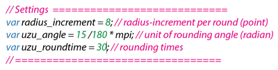

That looks good too! But you can also modify the script for the rounding times and radius increment.

Remarque: le script Archimedean Spiral.jsx est limité à 1000points.
René
Ici maxi rounding times 40
