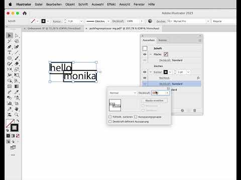

THis is what I did: https://youtu.be/aEUF5WN6ghU
Uploaded by Vektorgarten - Illustrator Tutorials on 2025-04-10.

Got it. Quite similar to what I did but you have a step where you introduce transparency (0% opacity). That is likely going to be a problem for me and it will rasterise when flattening the artwork.

Hi Monika. Where you change opacity to 0%, I left it at 100% and instead, changed the stroke to none. It seems to have done the trick. I think there should no longer be transparency anywhere.

Monika, I reproduced the steps in your video. If I change the stroke colour to none at 0:25, then leave opacity at 100%, and go through the remaining steps in the video unchanged, I get the desired result.
