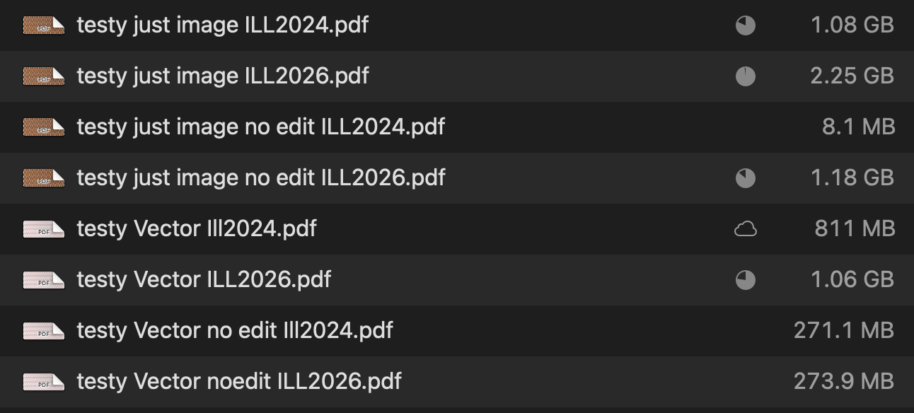

New Here ,
Nov 12, 2025 Nov 12, 2025
The problem seems to be the way illustrator is handling images(JPG)
Illustrator 2026 normal save 2.25GB!! vs 2024 1.08GB
Illustrator 2026 no edit save 1.18GB!! vs 2024 no edit 8.1MB!!!!!!!!! thats over 1GB difference.
For vectors only
Illustrator 2026 normal save 1.06 GB vs 2024 811 MB So slightly larger files
Illustrator 2026 no edit save 274 MB vs 2024 no edit 271 MB! So no real difference to npreserves editing unticked

New Here ,
How would that change the outcome? It just creates a shortcut, which I do for when i compress files which isn't an option here.
With the experiment above it is clear Adobe have changed something when handling JPGS.  The standard file is almost double the size of what it used to be.  Thats crazy. The none preserve editing capabilities is silly, 1.18 gigabites compared to 8.1 megabites! Thats not even on the same planet.

New Here ,
Heres an image of the results
