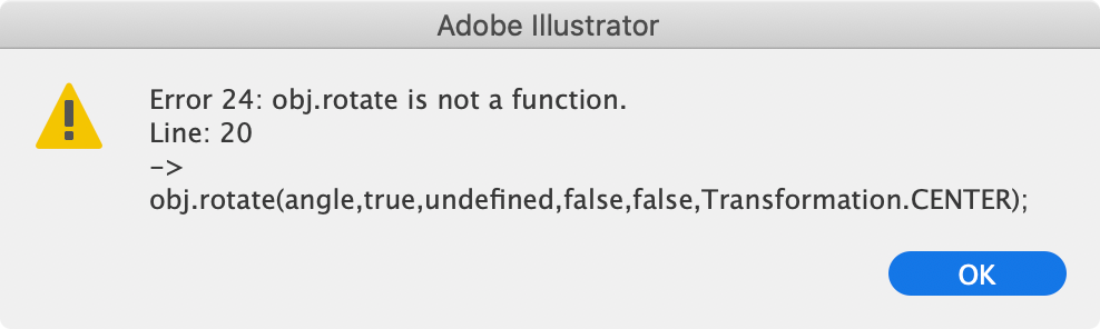

Community Beginner ,
May 28, 2020 May 28, 2020
Was excited to find this thread but in every case I've tried here I get this error.
Maybe something has changed in the newest releases of CS.
Hi julian, the new forum format messed up existing scripts, try this version
