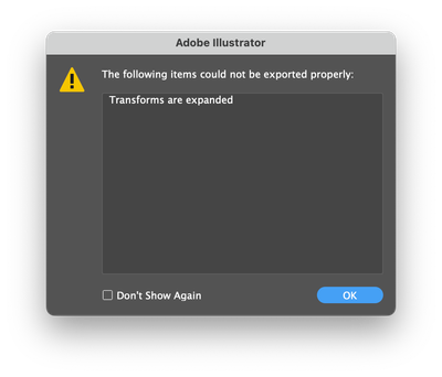

Now, could you please help me understand why the file "4-b32-Vc" is not behaving as well as the other two? Upon opening it in Illustrator I can see the whole staff (5 horizontal lines protruding at each side of the figure) and, even if I fix it to how I want it, I get the error "Transforms are not expanded".
I have tried everything I know to fix this but I am now completely stuck because, when I import this new file into Sibelius, it is missing its bottom portion, and looks like this:

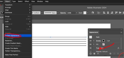

You probably have some type of transform effect on a vector object. Select the object. Object >> Expand Appearance

I've done that and still it exports wierdly in such a way that the receiving program places it cut of some part of it.
Any other idea?
PS: it seems that I had Scale Strokes & Effects checked but, upon unchecking that, the improvement is modest.
