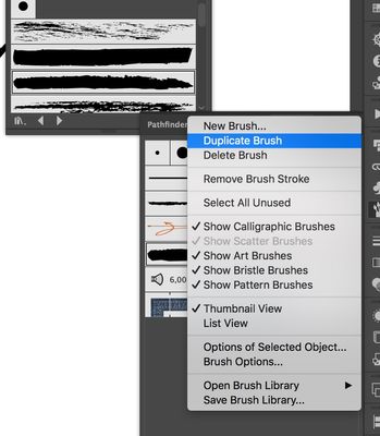

I had already started to upload, but you will have it as a separate instance of the brush, you can also duplicated and rename it see my screenshot:
