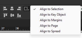

Mar 06, 2023 Mar 06, 2023
It's a drop-down next to the alignment icons on the top bar:
Choosing the alignment method can completely change how the selected elements align.

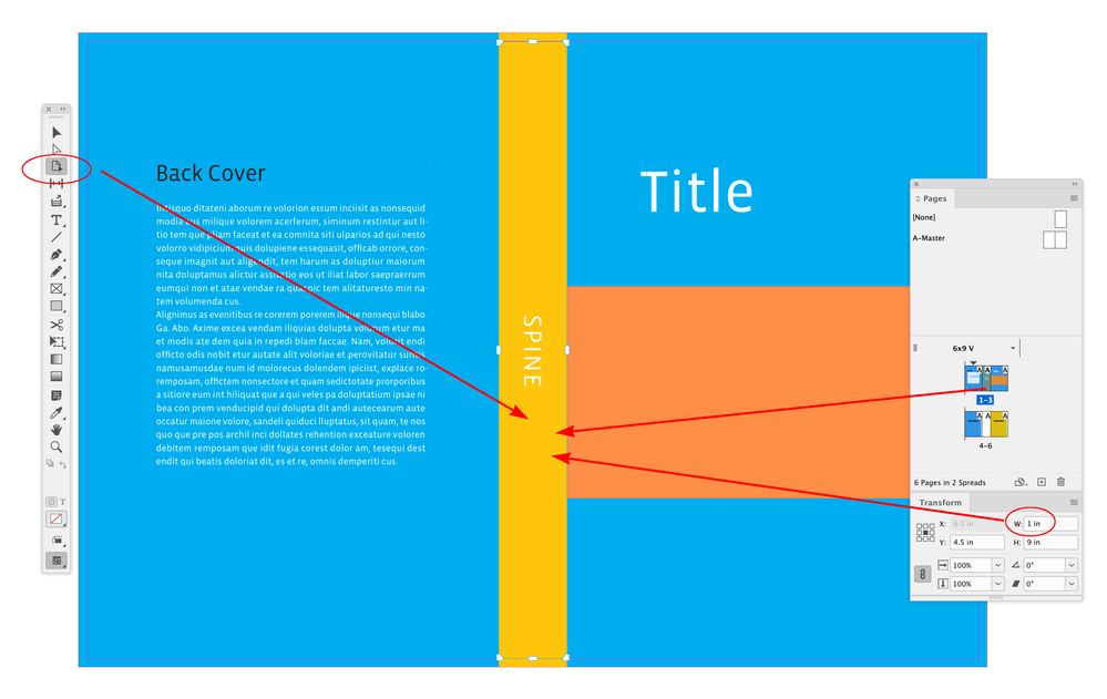

Hi @Joe-New-to-ID, The Selection needs to be the spread’s pages—with the Pages tool active, click on a page or pages you want to select in the Pages panel

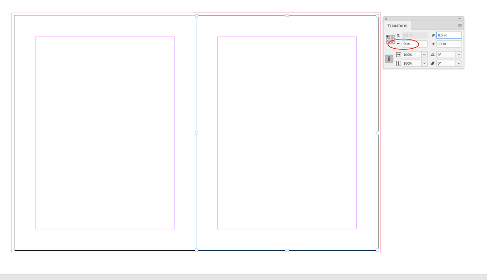

Another way to do it is via the Transform panel. Right-click your Rulers and make sure Ruler Per Spread is selected, then with the tranform Reference Point set to upper-left select the page that is out of alignment and set its Y to 0:

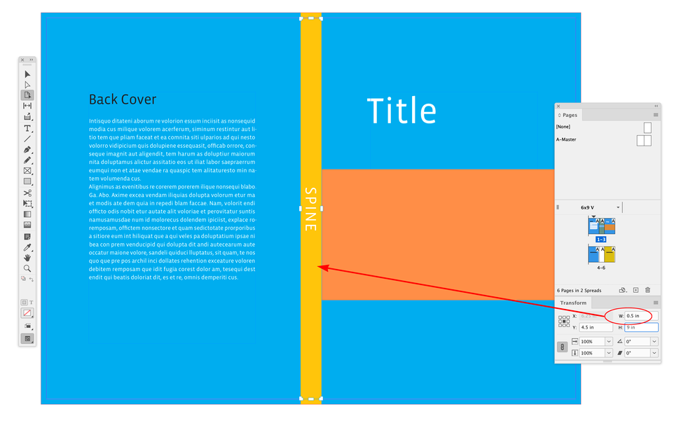

I then went back to Document Setup and unchecked Facing Pages
Ideally you want to leave Facing Pages checked, then the spine page width can be adjusted without affecting the front and back covers. Here I’m changing the spine width from 1" to .5" without needing to make any additional adjustment (the spine content is on the bottom layer):
