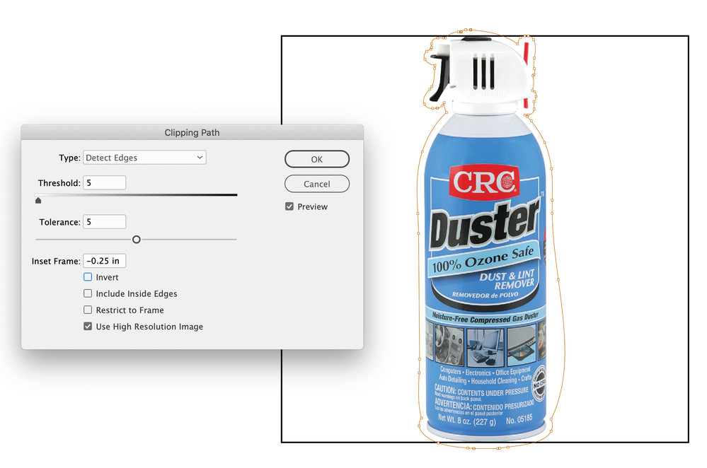

Hi Uwe & Red, have you considered using the InDesign clipping path/detect edges tool? you can apply a negative frame inset, which removes the interior white areas from the path.

I tested that as well, Luke. It's not perfect for what I had in mind, but it might be the best option. The main problem with that: the rectangle frame tool doesn't allow the clipping path to detect edges—at least everything I've tried. It can only be done after an image has been loaded.

Hi Luke,
yes, I also considered that option. The issue: you cannot tell programmatically which one will fit better.
So I really think, that PhotoShop should find the drawing pixels vs. the white ones and then either crops the image or does a rectangular clipping path. Thing is: you first have to find out how to do this reliably by scripting PhotoShop.
