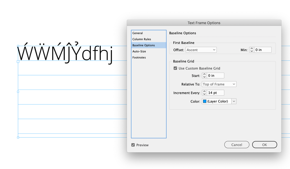

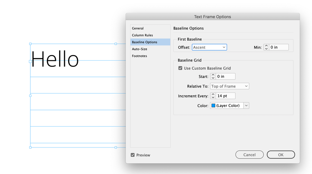

The Google TT version seems to have a different Ascent metric:
But the Ascent line is dependent on the font:

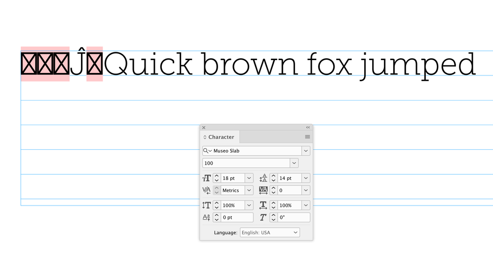

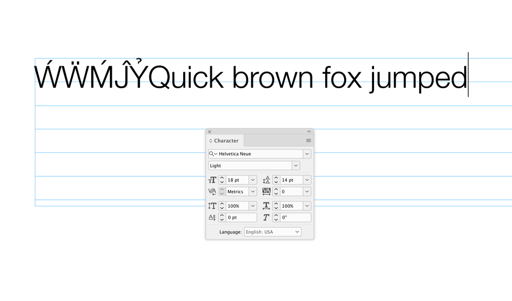

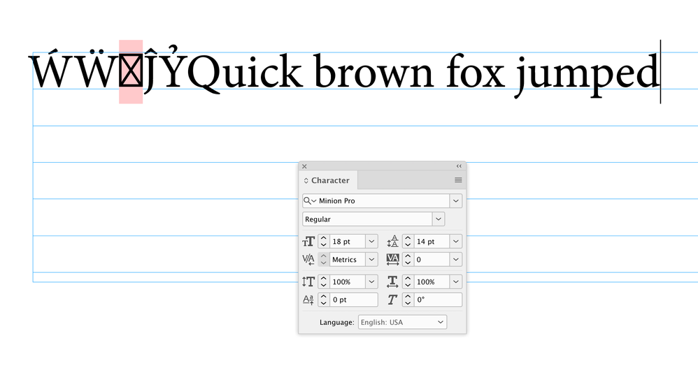

Hi Brad it looks like some type designers choose to include diacritics, while others define the ascent as the top of the lowercase characters. Seems like most Adobe designed fonts (Minion, Myriad, Adobe Garamond, Caslon, etc.) do not include the diacritics:
Screen Shot 29.pngScreen Shot 30.pngScreen Shot 31.pngScreen Shot 32.pngScreen Shot 33.png

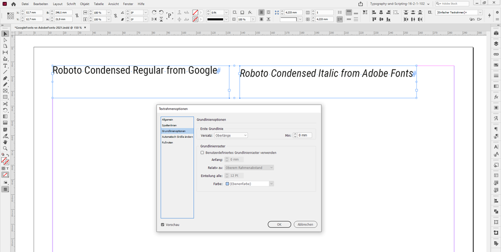

Hi Brad,
thanks for that! Maybe you remember this thread from June 2021:
Space added above and below Source Sans Pro and Roboto Adobe fonts
anneka_rose, Jun 10, 2021
https://community.adobe.com/t5/indesign-discussions/space-added-above-and-below-source-sans-pro-and-...
where I showed the Roboto from Adobe Fonts next to the one from Google Fonts:
Now it's very clear what exactly happened!
