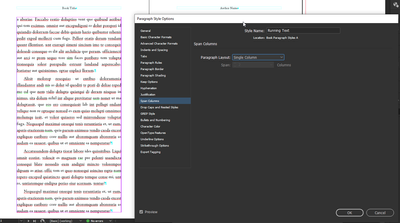

@James Gifford—NitroPress If you had it set in your paragraph style, you could change it universally here:

I know I can change column span, but this document has 30+ styles. Not really a good option.
I'd like/hope to just change the page format itself to one-column, without having to do it manually on each text frame.
