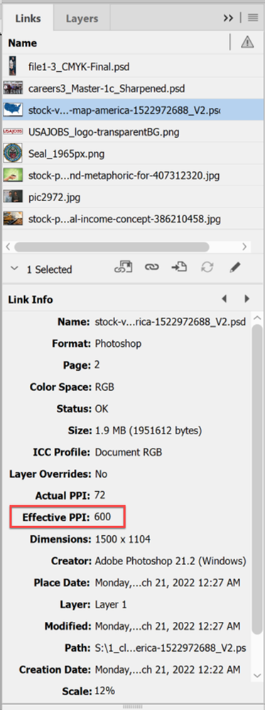

Build your layout to size, 7 x 5.5.
Ensure that placed bitmap graphics (aka, Photoshop files) have a final Effective Resolution of 600 ppi after you've scaled them in your layout. Check that in the Links panel:

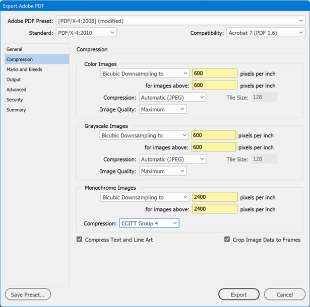

When done, Export to PDF (Print). In the export settings, set the compression to 600 ppi:
That should work for the print shop.

Explorer ,
Apr 07, 2022 Apr 07, 2022
One quick question—is it ok if the effective ppi is larger than 600 ppi or should it be exactly 600?
People's Champ ,
OK to be greater than 600 ppi. When the PDF is exported, the settings shown above will reduce the extra ppi down to 600.
But lower-rez graphics won't be up-rezed to 600 dpi.

@toddeindc, build your bitmapped graphics/photos to the highest resolution possible — that is, have the maximum amount of pixel data in the file. If you're snapping a camera's shutter, set it to RAW with the highest number of pixels. Scanning? Max out the resolution of the scanner and double the size (2x enlargement).
Place the hi-res file in your InDesign layout, resize and crop it, but make sure that the final Effective Resolution is a minimum of 300 ppi, or in your case, the 600 ppi your printer has requested.
Export the PDF for press with the compression set to 600 ppi as your printer has requested.
And if you will also export an interactive version for posting on a website, set its compression to 300 ppi, which is the highest Acrobat has preset in today's versions.
So if the print shop says 600 ppi, then 600 ppi it is!
If it turns out they don't need that high a resolution, they'll dumb it down during prepress. No harm done.
