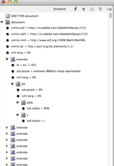

New Here ,
Oct 08, 2013 Oct 08, 2013
I also have this problem with CS6. Here is my code:
var uia = app.scriptPreferences.userInteractionLevel;
app.scriptPreferences.userInteractionLevel = UserInteractionLevels.NEVER_INTERACT;
var doc = app.activeDocument;
var root = doc.xmlElements[0];
$.writeln(root); // [object XMLElement]
$.writeln(root.markupTag.name); // document
var endnotes = root.evaluateXPathExpression("/endnote"); //return
$.writeln(endnotes); // nothing
var endnotes1 = root.evaluateXPathExpression("//endnote");
$.writeln(endnotes1); // nothing
var endnotes2 = root.evaluateXPathExpression("endnote");
$.writeln(endnotes2); // nothing
var self = root.evaluateXPathExpression(".");
$.writeln(self); // nothing
app.scriptPreferences.userInteractionLevel =  uia;
The evaluateXPathExpression does not even find the self:node() ... I different elements in structure and it never worked.
Somebody have an idea^
I include a snapshot of my structure in Indesign CS6.
Thanks guys.

Enthusiast ,
Oct 11, 2013 Oct 11, 2013
Hi All,
As per the screen-shot "var root = doc.xmlElements[0];" will gives you the Doctype element not the root element "document". Due to this it is not returning the correct result.
Replace that with the following line,
var root = doc.xmlElements.item('document');
~Green4ever
New Here ,
Thanks Green4ever,
I tested with your suggestion and I get the same result. evaluateXpathExpression still doesn't work.
hirsute
