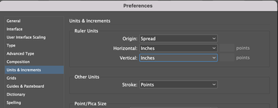

Feb 02, 2022 Feb 02, 2022
Open InDesign preferences, without any documents open, and select from the Units and Increments tab the units you want, such as Inches. When you next set up a new document the units should be the one you selected in preferences.
