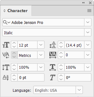

There is no issue with Adobe Jensen Pro Italic. Try disabling any auto activation plugins for fonts.

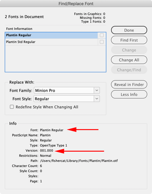

But some of the fonts Adobe has taken away were NOT Type 1
This is a licensing question and doesn’t have anything to do with the Type 1 EOL. Fonts are software and have version numbers and licencing agreements. Sounds like you are using different versions of Plantin
https://www.myfonts.com/collections/plantin-font-monotype-imaging/?srsltid=AfmBOooy9Wk0fyAtObhkcFTNy...
https://fontsgeek.com/fonts/plantin-std-regular
