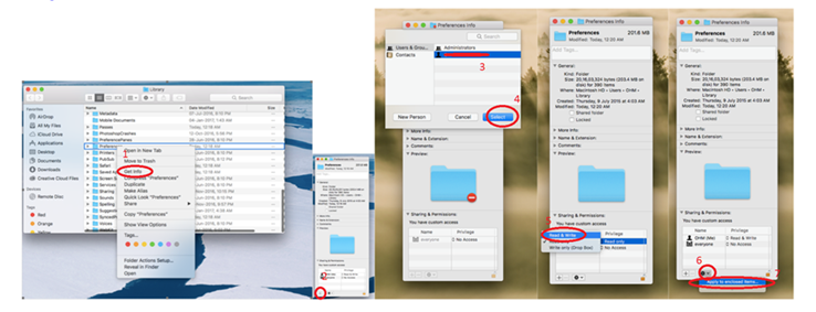

Sorry to hear about that. As per your query, while working on InDesign you often get this error "Changes cannot be saved as InDesign can no longer access the <file name and location> file". This indeed is a permission error but occurs generally on server environments but as you have already mentioned that you are working from your Desktop only, I would suggest you to check how InDesign works in the Root account: How to enable the root user on your Mac or change your root password - Apple Support
If it works fine in Root Account
• Go to Location ~/Library/Preferences
• Right-click preferences folder and click get info
• Click the lock icon to unlock it
• Click plus symbol
• Change permissions to read and write.
• Click the Action pop-up menu, then choose “Apply to enclosed items.”
• If you do not see your account there click on plus symbol on the bottom left corner and add account and follow same steps
Follow same steps for
~/Library/Caches
~/Library/Application support
/Library/Caches
Note: If you are on office system, these (/Library/Application Support and/Library/Preferences) folders may or may not allow you to add the user, that is completely fine.
Restart the system into your account and check how it works.
