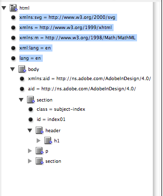

I have added this but no result for the below code.  If i change the xpath to "//*" its returning count.  For the xpath "//section" its returning 0;
var xPth = "//section";
var doc = app.activeDocument
var myRoot = doc.xmlElements.item(0);
if( !myRoot.xmlAttributes.itemByName("xmlns:xml").isValid )
    myRoot.xmlAttributes.add( "xmlns:xml", "http://www.w3.org/XML/1998/namespace" );
if( !myRoot.xmlAttributes.itemByName("xmlns:aid").isValid ){
    myRoot.xmlAttributes.add("xmlns:aid", "http://ns.adobe.com/AdobeInDesign/4.0/" );
elts = myRoot.evaluateXPathExpression(xPth);
alert(elts.length)

As adding xmlns:xml did not help, I would look for other namespaces deeper in the document.
For Kasyan's approach it will probably be faster to perform the suggested changes via an XSLT executed during import. On the other hand that assumes XSLT knowledge.
