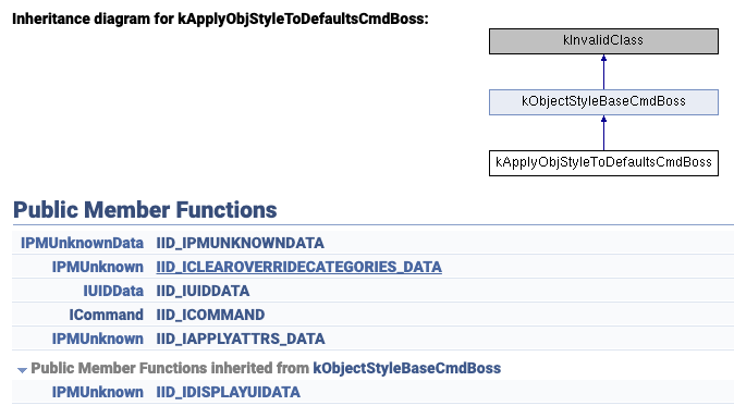

2) Using kApplyObjStyleToDefaultsCmdBoss
InterfacePtr<ICommand> applyObjStyleToDefaultsCmd(CmdUtils::CreateCommand(kApplyObjStyleToDefaultsCmdBoss));
if(!applyObjStyleToDefaultsCmd)
  break;
InterfacePtr<IUIDData> UIDData(applyObjStyleToDefaultsCmd, UseDefaultIID());
if(!UIDData)
  break;
UIDData->Set(DATABASE, UIDStyle);
if(CmdUtils::ProcessCommand(applyObjStyleToDefaultsCmd) != kSuccess) // Thread 1: EXC_BAD_ACCESS (code=1, address=0x0)
  break;

Hi @Stefano5C37,
There isn't much we an do if we have undocumented IPMUnkown interfaces, we don't have the header files included for the interface hence we can't possibly use it. In your case did you trace the process by doing the process manually and then checking the commands InDesign fires and the interfaces it shows in the trace. I suppose you are thinking on the same lines as I see your post that asked to how do this manually.

Unfortunately this generated documentation is very incomplete. The debug build already shows some more information. E.g. many interface IDs are just to have a minimum comment, or to allow duplicate use of the same interface. The backing implementation ID is one way to tell more, and you can even look up its name. This information is available e.g. from IObjectModel, IClassInfo. Likely the debug build even has some deeply nested submenu to output all of them as text, I don't know because I use my own that also includes the data from the interfaces, as far I have covered them over the years.
Let's have a look at that kChangeDefaultTFObjStyleCmdBoss :
IID_IAPPLYATTRS_DATA : kBoolDataImpl, IID_IAPPLYDEFAULTFRAMEGRIDCMD : kFalseInitBoolDataImpl are IBoolData.  IID_IDISPLAYUIDATA is not so obvious, but another IBoolData. Not sure where I found out about that a decade ago. IID_ICLEAROVERRIDECATEGORIES_DATA : kObjStylesAttrCategoriesListImpl , so that would be an IID_IOBJSTYLESATTRCATEGORIESLIST => IObjStylesAttrCategoriesList.
Of course that IID_IPMUNKNOWNDATA points to another boss, now – the first time that I looked at this – that would be an kObjectStylesTargetBoss which I don't remember having come across. Pretty similar interfaces to an object style itself, but that's where I'd also burn a few hours to see what they all mean, especially in this context, how to prefill them etc.
