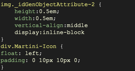

I understand your pain! Having to juggle between multiple readers and each showing me a different layout really boils my blood. I did assign it an object style with a generic code but it still doesn't seem to work Screenshot 2022-11-24 at 11.59.04 PM.png

Okay, that's a starting point.
First, give the icon a named style so that it's easier to distinguish from the many that ID creates on the fly. It should be applied at a div level, not an img... an img can be encapsulated inside another structure and CSS will thus have little effect on its positioning.
In a supplemental CSS file (if you're not using one — you don't quite say), create a matching definition:
div.Martini-Icon {
float: left;
padding: 0 10px 10px 0;
This should make the icon float left, let the following text wrap around it, and apply 10px of spacing to the right and bottom margins. (I think that's what you're trying to achieve... if not, adapt or describe it more fully.) With all suitable CSS commands, keep applying factors to the icon frame until it appears where and how you want it.
A second definition beginning with img. might be useful for controlling the actual icon graphic.

does something like this look okay?

Sure. You don't have to repeat anything that's in the default file, although I'd still recommend giving the image a more specific or unique name. (ID can change the generated object names for many reasons.)
I think the following would work more reliably:
div.Martini-Icon {
float: left;
div.Martini-Icon img {
(actual image characteristics here)
You'll have to tinker (by, say, giving the image a large size or something) to make sure the code is being applied; I'm just winging this.
