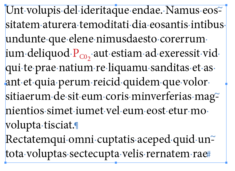

How's this? If it's OK, set C02 as subscript, then raise C0 with baseline shift, leaving 2 without baseline shift.Screen Shot 2020-04-08 at 5.59.02 PM.png
Community Beginner ,
Apr 08, 2020 Apr 08, 2020
Thank you so much. It worked!
I have actually moved base line for CO one point up and for 2 one point down and made the size of 2 a little smaller.
But, for a technical text it would be very handy if this can be done with subscript tool somehow. Of course I could have made the glyph in MathType and insert it into the text as an inline object. Although it would be perhaps better as far as the sizes and positions of all elements are concerned, but editing if required would be much complex. So perhaps Adobe can consider extending the subscript and superscript functions to two levels.
Thanks again, Jan

To resize the subsubscript, don't use a fixed size in your character style but set its horizontal and vertical scale to 75%. Together with your baseline shift, this should perfectly mimic a regular subscript -- even when inside another subscript.
Specialized sub-subscripts are rare in common fonts. Cambria Math contains a number of specially-drawn "fatter" characters, so their relative weight will be the same for superior+superior and subscript+subscript, but unfortunately InDesign does not allow access to this feature. It also lacks the repositioning and resizing code to do this automatically.
