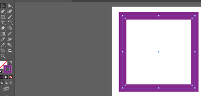

Illustrator Stroke
This is how the stroke is applied in Illustrator.
I can't find a way to fill an object with the stroke colour using the eyedropper tool.
But it might only look like a stroked object as a hollowed out rectangle like below.
This would make the fill pink but looks like a stroke.
And when you sample this and apply it in Illustrator sure it fills with the colour as it's filled in illustrator.
It actually has no stroke, you can can see that in the screen shot, the stroke is null with a red stripe in the bottom left.

Yeh I can't replicate it, no idea why your file shown in the video is pink and the file I asked for and you supplied is yellow? Why is that?
This is how it looks when I open it
So I have to change the Fill to something else - not a problem
Now I have a filled Pink square
Now I select the yellow stroke
The use the eyedropper and shift click the pink rectangle
It applies the fill and not the stroke as the sample doesn't have a stroke, how can it sample it or apply it?
I cannot find a key combo that applies the fill colour to the stroke.
I've toyed around in the options for the eyedropper and no combo in their does what you're showing.
Holding down Alt with eyedropper applies the stroke to the other object
Change the setting get slightly different behaviour
This is using Alt click with eye dropper after changing the settings
Anything I do in Illustrator does not change the stroke colour to the fill colour.
