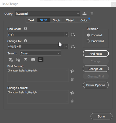

Are you saying you want the highlight to extend beyond the words slightly?
If so, apply your character style
Do a GREP find/change as shown (the size of the space before & after is up to you; I used a 1/6 space).
Result:

Thank you, David. I just tried it, but if you select one complete line (see the attached image), the margin appears only at the first word (see point A.) of that sentence, the second and third line get no margin (point C.). Unless you put a hard or soft return (point D.) at the end, then the new line starts with the margin (point E.). I want every line to start and end with a little margin without using returns, so if editor changes the text, it adapts naturally.
