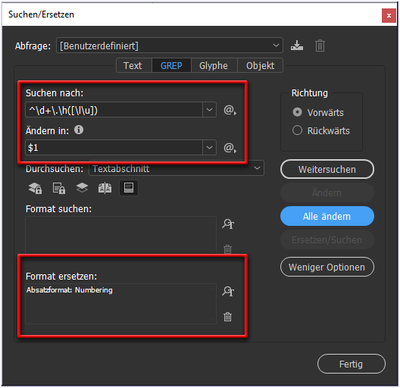

Create a new paragraph style with a numbering list.
Then I would remove digits, dot and space with Grep and at the same time assign the new created paragraph style with the numbering list. This will make handling much easier in the future.
F:  ^\d+\.\h([\l\u])
C:  $1

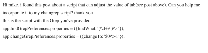

Im creating a script using ChainGrep, so technically I want to compile every GREP i need to build a script that will automatically format everything without using any paragraph/character styles. Everything is working fine now, but I want to add another feature were it can set the value of the tab char to 0.125 in.

ChainGREP does the sequence of separate Find/Changes.
One of the Find/Changes applies Formatting via a Paragraph Style
The Paragraph Style supplies the Tab distance value.
It is all a trickle-down.
