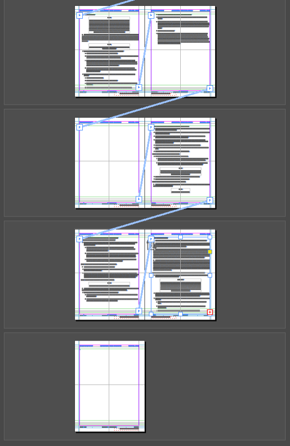

All of a sudden, InDesign has decided to repaginate a non-open file after every edit to the document that IS open. This takes several seconds of modal dialog.
Worse, however, is it adding page after empty page to my currently open document as I adjust the spacing on ONE page of it. Also, an unknown number of pages' worth of text has now disappeared from view entirely.
And I can find no way to reliably prevent InDesign from allowing spreads to go beyond two pages. I NEVER, NEVER, NEVER WANT THIS. I have experimented with every combination of allowing document and spreads to shuffle, and nothing prevents this behavior reliably. You also can't move the erroneously-positioned added pages to the correct side, again regardless of how you set the shuffling options.
So fed up with this mess.
If you add a page manually, you can sometimes get it on the correct side, but it's not connected.

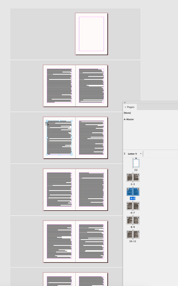

Hi @Thomas_Calvin , make sure you are allowing all document pages and spreads to shuffle. Select all the pges in the Pages panel and check both--the settings are page/spread, not document settings:

I've tried every combination of these "shuffle" settings, and every possible combination produces an incorrect layout at apparently arbitrary points.  InDesign will either skip a side of the layout for no discernible reason (add a page on the right where there's no left page), or add endless pages to the right as depicted here. And then you'll usually be prevented from dragging a page to the correct position.
It seems that InDesign has tried to cram several conflicting settings into these ineptly-named ones. What we actually need are independent settings for:
  • How many pages per spread, strictly enforced except for the first and last.
  • Never skip a page and leave one side empty, except for the first and last.
Oct 27, 2025 Oct 27, 2025
Make sure you are setting your Allow... preferences for all of the pages—in your capture you only have page 54 selected. The Allow... preferences can’t be a document preference because you might need to include one or more gatefold spreads.
Also check your Type>Smart Text Reflow preferences. Here I’m using Primary Text Frames and Adding Pages to End of Story:
Pasting in long text into the page 4 Primary text frame:

Also, turn on your invisibles and make sure you don’t have some kind of break character accidentally inserted—Type>Insert Break Character.
Here I’ve inserted an Odd Page Break, which replicates your capture:
Odd Page Break character:
