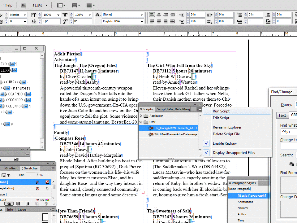

Sorry, I must be doing something wrong now. I've followed the process to the "T", but when I get to the stitch together script, the text boxes merge over one another like this:
Here's a reprieve of everything we figured out, step-by-step:
Step 1 Opened up the document merge template I set up and changed the CSV file:
Step 2 Created new data merge document:
Step 3 Included blank lines:
Step 4: Merged Document:
Step 5 ran your remove XML tag script:
Step 5: Document no xml tags:
Step 7 Ran the text search:
Step 8 Ran the GREP Search:
Step 9 Here's the Document without extra tags:
Step 10 Then I run the stitch together script:
Votes

Hi Lina,
I just tried the scrip on the first 25 records of your data file here and got some stagnge results, too -- the thread is non-linear, though I don't have any superimposed frames. The text is threaded correctly for me, though, as far as I can tell.
Try doing a select all for the text, then copy and paste into a new document and see if it looks correct.

At least  it seems, I got the right approach with my script stitching text frames together.
The order of texts will be the right one.
Uwe
