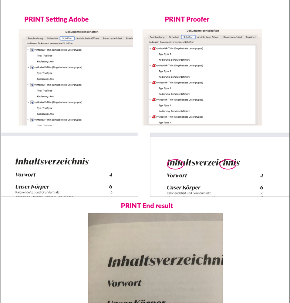

I have massive problems with publishing in this matter, see the screenshots here. How can I fix this problem as I have to upload the PRINT Adobe PDF to the Printer and its gets converted in like this. What are the Setting in Adobe that I can fix that issueBildschirmfoto 2023-08-17 um 11.52.46.png
Aug 17, 2023 Aug 17, 2023
So, to be clear. your PDF (left) is using TrueType OT) versions of the font, but your print vendor is sending you back a proof where the font is converted to Type 1?
1. Where did you get your fonts?
2. What program did you create your document in, and how did you create your PDF? e.g. if InDesign, did you proper;ly Export a PDF or did you use
It seems the printer has done something to cause the issue. Not clear why they would need to convert to Type 1 outlines anyway unless thay have an ancient RIP (over 15-20 years old) that doesn't handle TrueType (this was an issue back then). Can you upload both of these PDFs for someone to look at?
New Here ,
Aug 24, 2023 Aug 24, 2023
thats the thing, its loaded from the latest version of Indesign and Adobe Fonts and yes, you see the problem. I used the standard PDFX standard Profiles so I have no clue what to do. I work in the industry since 2004 and I had never such Problems. I need some help to fix this
Aug 25, 2023 Aug 25, 2023
Hi, @nilaatwork ,
afaik that happens when your PDF is printed again through the Adobe PDF printer with the default settings, as the default is: convert all TrueType fonts to Type1 fonts.
I am assuming Windows as the used OS.
If I am right (your print service provider is handling your PDF/X that way) there is nothing that you can do to stop it.
Only thing you can do is:
Talk to the print service provider about that problem and ask him to change the treating of your PDFs.
If he is willing to change, you're fine.
If not (either not willing or not possible due to old soft-/hardware), you can accept that or you must find another print service provider that is handling ypur PDFs correctly.

Thanks so much Stephan for your answer. I cant stop the provider as its global one, so they wont change anything, sad but thrue. The only thing is to go with old standard fonts which are more common and better produced, i think its a combo of bad produced fonts and the printing setting of the provider...
