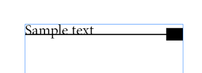

You mean something like this:
New Here ,
Aug 02, 2023 Aug 02, 2023
yes! how did you do this?
LEGEND ,
It's a workaround - you need to use both Rules - Above and Below - set one thin and the other thick - you can even use @Laubender solution to define different shape.
Then you need to set Left Indent - to have "the bullet" on the right end - but that's where it gets problematic - you need to know width of the text - as it won't change dynamically - so if the text line get wider - your "bullet" will be deformed.
You can even do something like this - to get rid of the line - using CharStyle and NestedStyles:
(I've used Yellow instead of White for better visibility)
Sample INDD doc attached.
