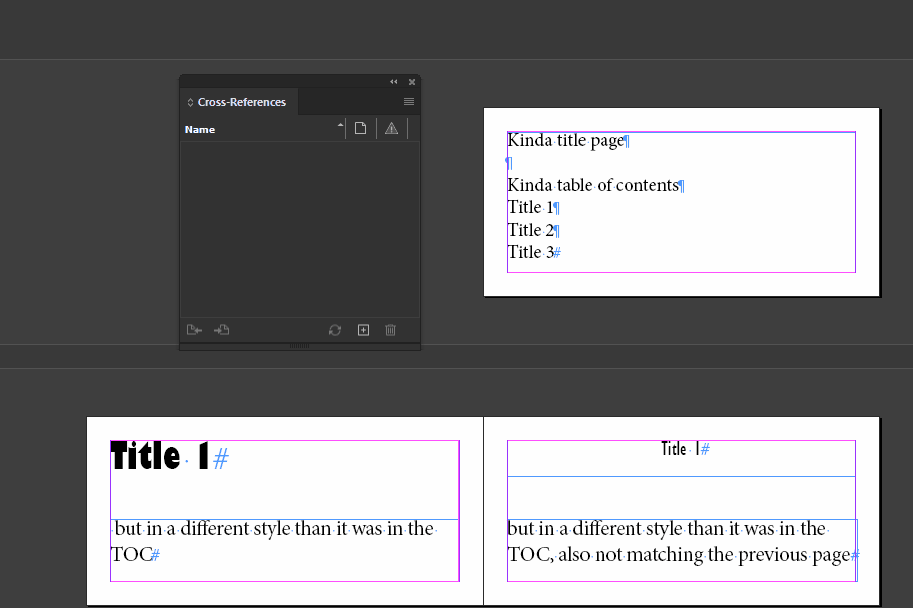

I am surprised that the running header doesn't work for you; it's pretty configurable. But if running headers won't cut it, you could use cross-references with a custom cross reference format:
Note that I had to edit the "Full Paragraph" cross-reference format to remove the quotation marks, and that I saved it so that the rest of the "Full Paragraph" xrefs I would make in this document would be free of those quote marks.

Huh. I see what you mean! I found that I could first add to the title, then delete the word "Title," if I deleted it very carefully. That's because there is a special character being added that is needed for the xref to work. If I modify the line but leave the xref anchor in place, the xrefs are modified and can be updated, but if I delete the xref anchor, it's gone and you get a "referenced paragraph or text anchor is missing" error. Check out the special character for the xref:
