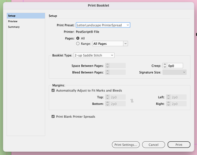

Hi @StuArtsy , You would do it via Print Booklet>Print Settings>Setup by setting the Paper size Width and Height and setting the Orientation. Something like this:

Hi @StuArtsy , Just to clarify, I may have misread your post, but I was assuming you are looking for this output:
And not this, which is what Brad @ Roaring Mouse ’s Setup will output:

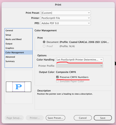

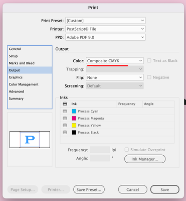

@StuArtsy . The Print to PDF function has been deprecated for some time from Adobe apps on the Mac ('for reasons"). This is not to say what you want is not possible, but as others have mentioned, it's not a good workflow these days, mostly because PS doesn't have the capability for higher-function PDF objects (like transparency). In which case, any PS file will flatten these objects. If you are printing to your own Postscript (i.e. non-native PDF) printer, this is not a big issue as this flattening would have to happen anyway at print time, but commercial printers (I am a printer prepress person) do not want you to do this; we want single pages. If you are dealing with one that is asking this of you, they are the archaic ones!
However, if you are printing this yourself, here's the proper way to do this these days:
Download and install the Adobe PDF 9.0 PPD (as mentioned in this thread). You CAN use your own printer's PPD if it's a PS printer and has the ability to create Custom Page sizes, but the caveat there is that this will generate PS that is specific to your printer which may not work if you take this PDF elsewhere, so best to use the Adobe PDF 9.0 PPD one.
If you are doing this regularly, save your sanity by Defining a Print Preset for the paper size and settings you will need. In your case, if you wanted letter landscape spreads with room for crops and bleed, make a page size 23" x 9.5". In each of the settings dialogs, you want to give the best information in your PS file, e.g Graphics > Images > "ALL" instead of "Optimized", etc.
I like to push crop marks outpast the bleed so I set my offset at 1/8" (0p9)
Color Handling: You probably don't want to pre-manage colors, so select "Let Postscript Printer...."
IMPORTANT ONE: Transparency Flattener "High Resolution"
Save.
Once saved, you can then Print Booklet:
Select your predefined Print Preset, change any setting there you need, check Preview, and print your PS file. Distill.
