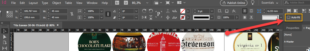

Mentor , Aug 12, 2019 Aug 12, 2019
un-check this "helpful" feature -

Mentor ,

Adobe Employee ,
Hi there,
Thanks for reaching out. As George mentioned, you can turn off the Auto-Fit feature from the control panel. For more details on frames and graphics in InDesign, you can refer to this help article: Work with frames and objects in InDesign
Let us know if this helps or if you need any further assistance.

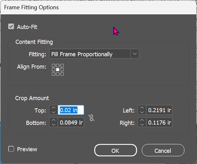

Sep 30, 2024 Sep 30, 2024
First, this thread is a couple of years old. If you are posting a "me too" issue to a thread more that a few months old, I would start a brand new post.
To disable Auto-Fit:
1. With NO document open, go to the Object>Fitting>Frame Fitting Options menu and turn off Auto-Fit if on. This will only impact NEW documents, not preexisting ones.
2. In a problem document, with NO object selected, go to the same menu and turn off Auto-Fit if on. This will impact new image imports, but not existing images.
3. On a per-image basis, select the image and repeat the above OR turn it off on the Control panel.
