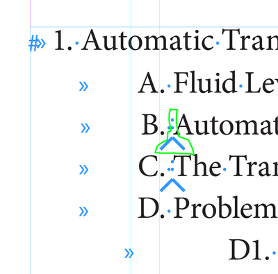

I'm attempting to resurrect a few old Quark files that I imported into InDesign decades ago (ID 1or 2). I've dealt with a myriad of problems so far but one just won't go away – weird substitutions for tabs in Minion Pro (an encircled 9), scissors and some other thing in Myriad Pro (in the green chapter blocks). See attached file. I'm trying to believe that just turning off hidden characters will suffice, but I fear that I know better. I ran the old ID files through IDML, then reopened them in ID 2022. Doing so eliminated the problem in one chapter but had no effect on the others. Thoughts? Suggestions? A fix? Thanks for any help you might offer.

Does manually retyping the content fix the problem? If so, that may be the only fix, with or without search and replace/GREP assistance. In cases like this, there are no settings or options that will fix "wrong text."
May 29, 2022 May 29, 2022
As far as hidden characters, I'm not seeing anything unusual. There are Index Markers throughout (as indicated in green on my grab attached), and the glyphs for your Altemus Dingbats are missing (since I don't have the font) and may need to be remapped anyway if you used old Type 1 before and are using an OTF font now, but that would be a simple search and replace.
Can you show a screen grab of what YOU are seeing?

This is a guess, and that's all it is, but since you say these files are going on twenty years old I suspect it's a case of "bad mapping" where the type designer just threw glyphs into the font willy-nilly and they don't necessarily match the unicode codepoints. Back then we used to also see strange mappings when switching between Windows and Mac flovors of the same font.
As James suggested, I would try a Find/Change, using copy/paste to populate the find field, and typing the correct glyph into the change field.

It's a font problem, most likely an old PostScript font, and probably some ancient encoding being carried over from the original QuarkXPress file.
Zooming in on the OP's original screen shot, there are shaded arrows between every word — instead of the normal blue dot to represent a spacebar.
Enargement of OP's screen capture: wrong glyph is used for blue dot/spacebar.Enargement of OP's screen capture: wrong glyph is used for blue dot/spacebar.
@– Pem –, I think this cruddy encoding is going to cause some problems for you, either as you attempt to adjust the layout or when you export a PDF for press. And if you're making an accessible PDF, definitely these spacebars will not be recognized by assistive technologies and the PDF might not be able to be read at all, or will be read as one ginormous word. Gah!
If you have to reuse the file to reprint, then make a test PDF and see if it prints correctly.
But if you need to do further work or need something more compliant, the you'll need to clean up the fonts in this horrible file:
