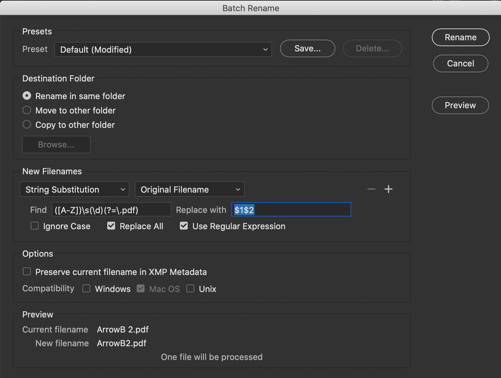

Given the attitude of the client, it would probably require looking over his shoulder to see what is happening. If he's not amenable to that, a batch renaming solution might at least help minimize the effort on your end. You could use Bridge's Batch Rename feature with Use Regular Expression enabled to quickly edit the file names.
If the string is consistent like the example you posted, and the number at the end is always a single-digit, then the following Find/Replace strings would work.
Find: ([A-Z])\s(\d)(?=\.pdf)
Replace with: $1$2
See the attached screenshot for additional settings.
