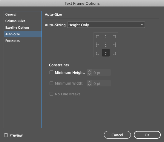

tf.textFramePreferences.autoSizingReferencePoint = AutoSizingReferenceEnum.BOTTOM_CENTER_POINT
tf.textFramePreferences.autoSizingType = AutoSizingTypeEnum.HEIGHT_ONLY
tf.fit(FitOptions.frameToContent)
I tried the above code and that doesn't seem to work in my case. Here are my text frame autosize properties.

That seems to be right, i demonstrated it working on the sample screengrab. So you mean to say it works for you when you do it manually and not via script, or did you not even try it manually and anyways asked for a code sample?
-Manan
