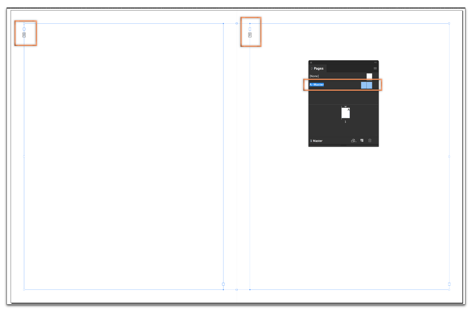

  1. Add the primary text frames to the A-Master.

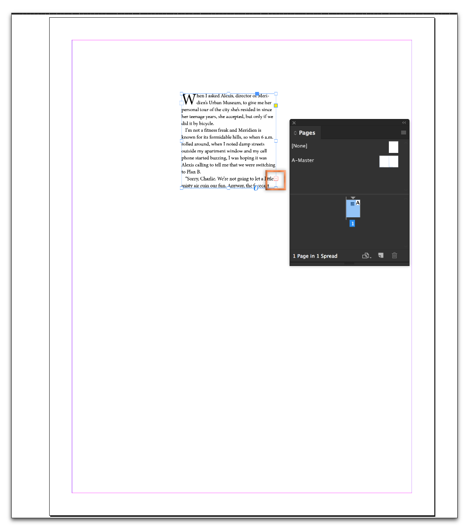

    1. With the Selection tool, Edit > Paste
    2. Click the red overset text icon in the bottom right corner to load the text cursor
    3. Press Delete to delete the small frame

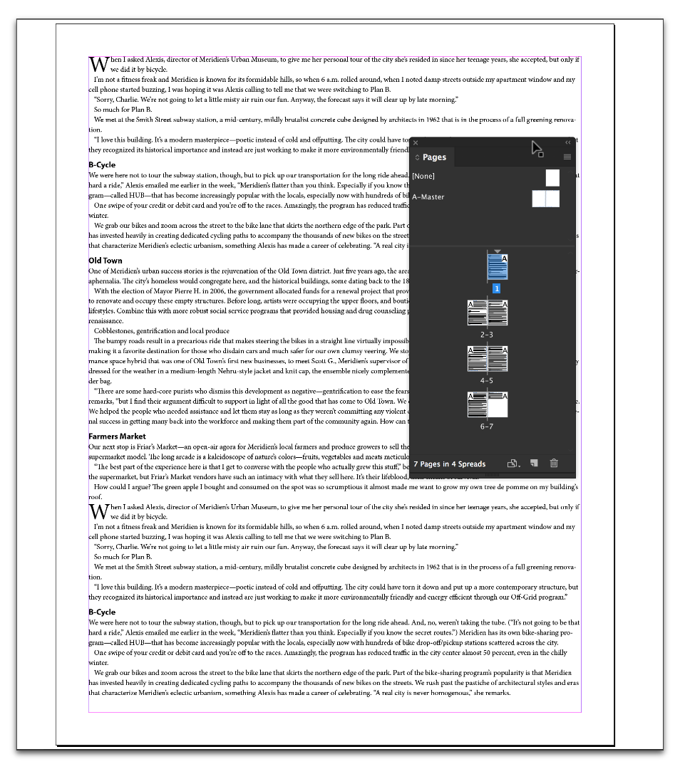

    5. Align the loaded text cursor with the top pink margin line. Press and hold the Shift key and click to auto-flow the entire story into the new file. InDesign will create as many pages as necessary to hold the new file.

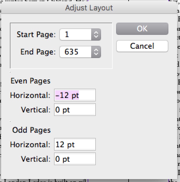

There's a script that comes with InDesign called "Adjust Layout" (you'll find it in the Samples > Javascript folder in your scripts panel) that will allow you to nudge all frames upwards. Very easy to use.
Ariel
Participant ,
Aug 16, 2017 Aug 16, 2017
I'm not seeing the scripts panel?
Windows > Utilities > Scripts > Application > Samples > Javascript.
I've never used the script but when you select a frame and double-click on "Adjust Layout" you'll see the dialog below:
Participant ,
Aug 17, 2017 Aug 17, 2017
Ok, I found the script, though I'm a little confused about the how-to...
I just want to raise all the text frames .0417 in, how would I work that in this dialog?
