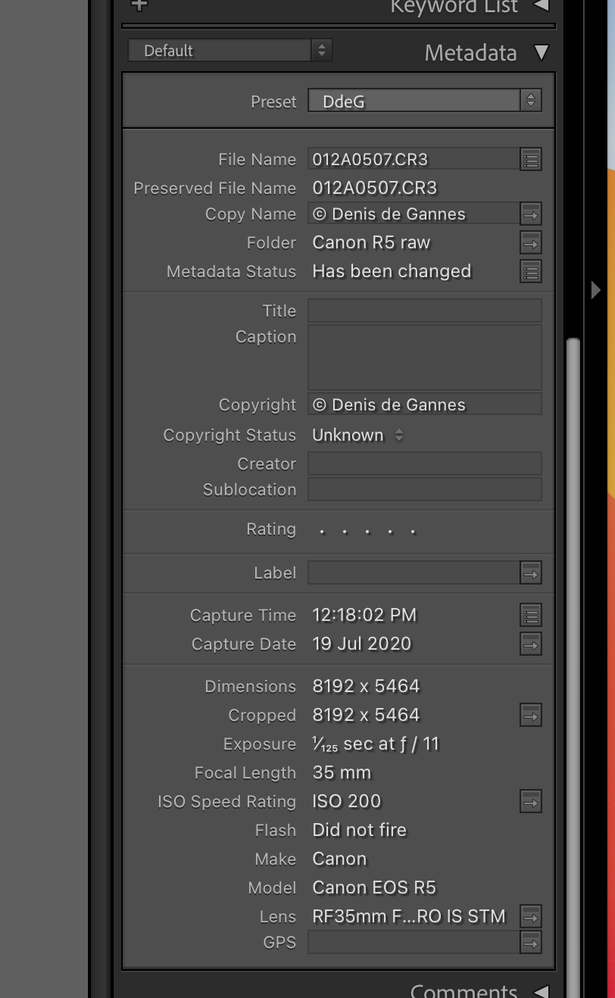

Jul 13, 2021 Jul 13, 2021
I downloaded two sample raw files from Canon R5 camera samples with two different lenses and both had Adobe Lens profiles available which were applied at import. I have no idea if this supplements the in Camera adjustment or overrides if with the Adobe lens correction.
I guess you could check the different effects by turning off the Lightroom Lense correction.
