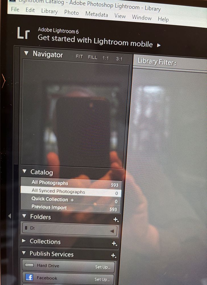

My apologies to start as I am technologically impaired. What may look clearcut to you in these instructions is confusing to me and I am reluctant to start anew when I suspect I am only a step or two from getting this done. I currently seem to have LR6 on the new computer and can bring up photos but they are all contain  check marks which means they are not recognized as already imported by LR. My 6.14 version of LR on my desktop computer has 400,000+ images and the version that I see on my new computer has 593 and reads LR mobile on top. I ran into this in the past and it seems that the synchronize process corrected the problem. I have already brought my latest backup (12-22-23) of my desktop catalog into the new computer but I suspect it is simply not located in the right place for LR to incorporate it. I will now display several images on my computer screens and perhaps you will be able to spot the error(s) and get me headed in the correct direction. I am sure this will be frustrating to you but the directions Queen sets forth are confusing to me. Here goes:

" can bring up photos but they are all contain check marks which means they are not recognized as already imported by LR."
And again- you should NOT be Importing!
You have most likely started another catalog- ie. Not the one you copied from the old computer, or you copied the wrong catalog from the old computer.
~Did your "latest backup (12-22-23)" when opened on the new computer show all your 400,000 photos ? This would be the catalog you re-link to the copied original photo files.
~[All Synced Photos] in the Catalog panel is information about any Cloud synchronization- NOT local linked photos- and NOT relevant to you. You cannot 'Sync' Lr6.
~ "reads LR mobile on top".  Totally irrelevant to you with Lr6. You cannot 'Sync' Lr6. Lr6 has no Cloud functions. Ignore this suggestion to "Try...".
The instructions link given by @dj_paige above, remains the most informative procedure for moving to another computer. Read it again and again until you understand it.

(1) Yes, as shown in last photo,
I see a Lightroom folder, but not specifically a Catalog file  (Lightroom Catalog.LRCAT). You only show the Previews folders.
(2) No, I have the photo files on an EHD and do not plan to add them to the hard drive on the new computer but simply plug in the EHD when needed,
That's OK, but you will need to re-link the folders in your catalog to their 'new' address on the external drive. MISSING FILES & FOLDERS (Lightroom Queen)
(4) the catalog that I copied to the new computer is the one that I grabbed from my desktop computer on 12-22-23 when closing it out; it shows 400,000+ previews.
Well it is not the one you show in your second screen-clip. The Screen-clip shows a catalog with only 593 photos. That is not the "400,000" catalog.
