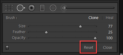

You're using the Spot Removal tool, which clones or heals using the surrounding area.Try using the Adjustment Brush as shown below:

Lauren, the screenshot you posted shows the Spot Removal tool (see below). Perhaps you applied it by mistake and then tried using the Adjustment Brush?
Try this. With the posted image file selected click on the Spot Removal tool and then click on its 'Reset' as shown below.
